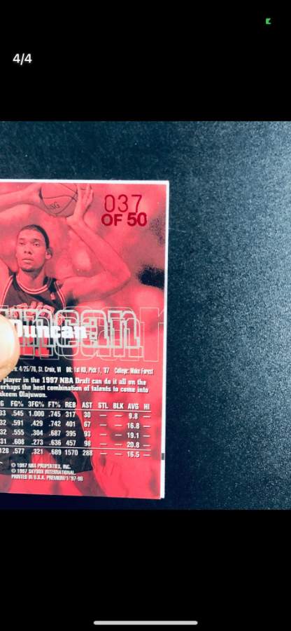

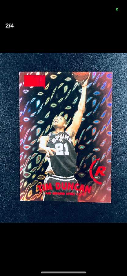

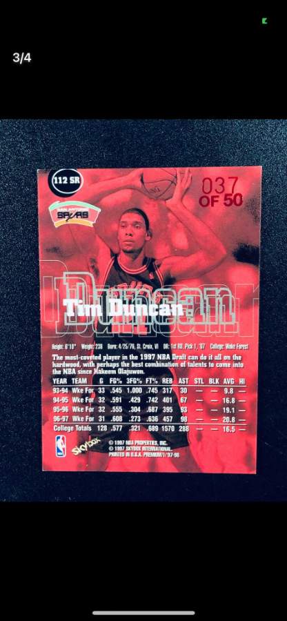

Re: 90s Fake/Backdoored/trim Cards
A trimmed 1997 Skybox star rubies Tim Duncan was sold to a USA buyer in China auction. To my surprise the seller has been bluntly honest that it is a smaller card.

siuwongkee wrote: Sun Jul 23, 2023 9:24 am A trimmed 1997 Skybox star rubies Tim Duncan was sold to a USA buyer in China auction. To my surprise the seller has been bluntly honest that it is a smaller card.
Sucks to see.. With so few of those out there it's always discouraging seeing a hacked up copy.
Posts: 116
mindcycle wrote: Tue Jul 25, 2023 3:57 pm
I thought of buying it, in the end it is numbered to 50. But at the same time there was an Ray Allen rubies 1998 PSA 8 so I go with the Ray allen. I mean at least the seller is being responsible and telling you it is trimmed. I suppose many will just sell it casually and then the buyer will just send it to grade and back a PSA 6 or BGS 7.5.

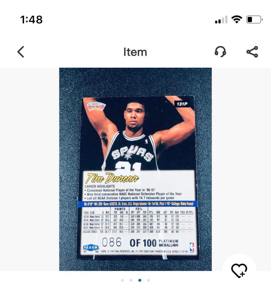

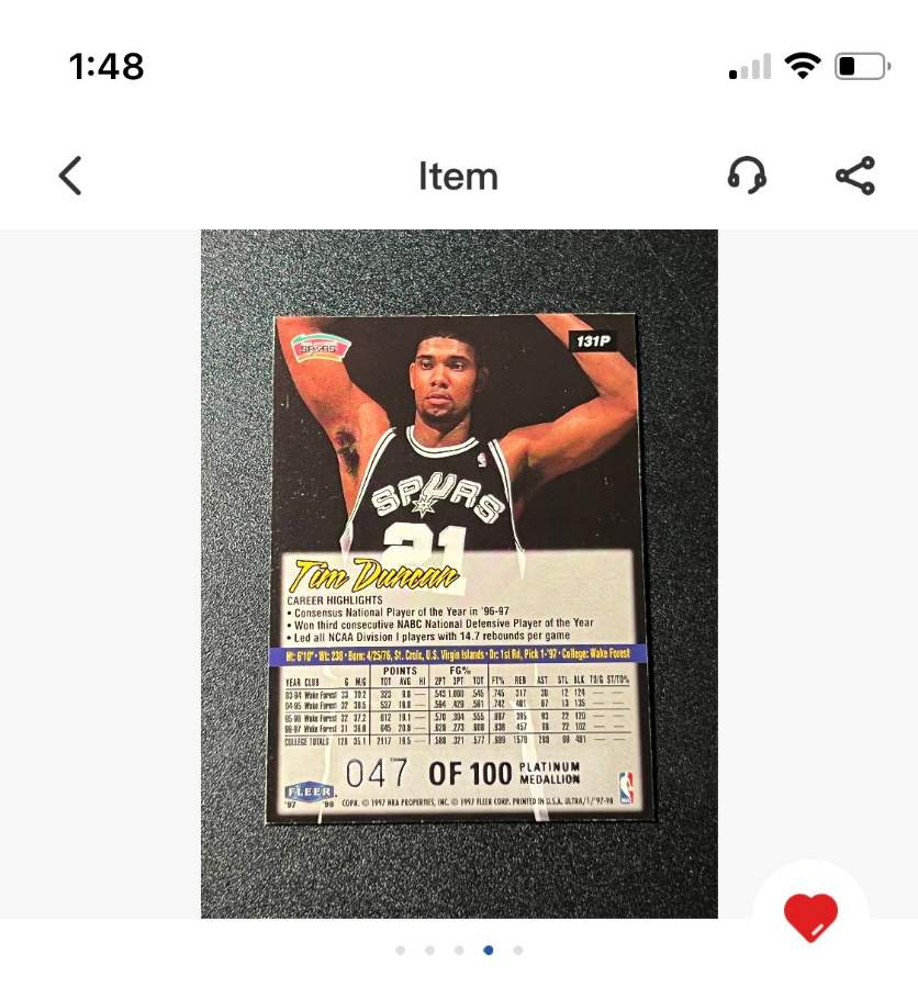

2 more trimmed 1997 Medallion Tim Duncan, not sure if it is backdoor/fake. Sold by the same seller.
